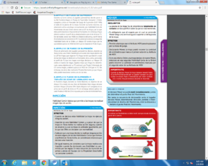

    Correction, it does appear, but rather in the intro section, rather than in the movement section. I was wrong.

    I've very much based my remarks in this debate - particularly with regard to the Etiquette section, on a lengthy personal duscussion with Gutier (Lusquiños, Director, rules author) on 27th July 2017.
    During the discussion, we worked from the English version for my benefit, but wanting to cross-reference the Etiquette section, Gutier could not find it in his Spanish rulebook. It wasn't an exhaustive search, but it's just what A Mao has posted.
    Maybe there are revised versions of the Spanish rules, or perhaps both A Mao and Gutier overlooked it somewhere else in the text; I don't know. Can you give us an edition and page reference, please?
    For what it's worth, (I can't speak officially on behalf of CB) Gutier's personal explanation of that section to me is very much as A Mao has posted, and I hope his and my posts read reasonably consistently.
    The topic of 'play by intent' was later discussed with Fernando (Liste, Director), HellLois and Palanka and I also had the benefit of personal instruction from Palanka.
    I'm entirely clear that A Maos posts are a good representation of those views too.
