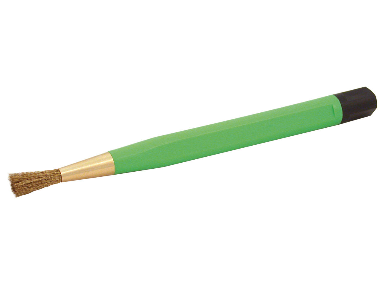

    This reminds me I have to find brass refills for a brush pen. I got fiber glass "tips", nice for other things except that you need gloves and glasses and work under water, or suffer "painful itches" next day. That or buy some tips used in minidrills.

    Is the brush pen used for scratching lines in things? I've heard that some people use them to add detail to bases. The only "Brush pen/pencil" thing I have is a pencil brush, which is a contraption that holds 0.9mm leads in a flat row - used for illustration and shading.
    I am not familiar with these fiberglass tips. They work underwater...?

    This pen. You rotate the black end and the "hairs" go in or out, spreading differently and being harder/softer in the thing. Yes, they work underwater, in the fiber case I suggest that unless you want nasty tiny spikes of glass everywhere. The fiber glass tip looks like a white stick in photos, but believe me, it's a lot of "hairs", and they break easily with use. The shop suggests water both for brass or fiber. I know other places also sell steel tips, those will rust if you don't dry them well later (use oil instead?), and for pewter it's overkill. There are also wheel (disc), cup and point brushes for minidrills, in steel and brass, that can be used by hand in delicate parts.
    The "scratching lines" pen is a scriber, single sharp tip of very hard material, like carbide. Normally used to mark things, like "drill hole here", but in miniatures it's useful to mark panels in airplanes, bases, etc.

    A set of dentist's picks may help get that hard-to-remove primer out, as will brass brushes. Brass brushes are usually cheapest in gun-cleaning supplies.
    Yeah, if you get one of those fiberglass scratchers, you do NOT want to use it in open air, those microscopic fibers will get everywhere. In your skin just itches forever, but in your lungs is bad. Asbestos is microscopic fibers, just like fiberglass.
