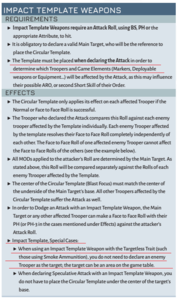

  3. Nuada Airgetlam
    It's still an Impact Template Weapon, just non-lethal.
    Impact Template Weapons require placing the template on the table to see what's affected. Special Case: Targetless (Smoke) means only that you do not need to center it on an enemy model's base, it can be any point on the table.

    To expand on what @Nuada Airgetlam just posted, the second bullet in requirements is key. you still designate a target ( in the case of smoke a spot on the ground often times) and use that to place the template. Short Answer, it works like N3, I think.

    The target is a "reference to" placing the template, whether it's a model or an "area" so I think it's option 1. I think "area" is a bad choice of word though, it should be a point.

    If we're not carrying over N3 solutions, so we assume that Helllois' ruling no longer applies and look only at the current wording: where are you finding that bullet point? I'm not seeing anywhere in the rules referring to targeting a "spot on the table."
    The only bullet I've found is page 50, first sub-bullet under "Impact template, special cases" which reads "the target can be an area on the game table."
    To me, the most likely meaning of "area" is the area covered by the smoke template. So you place the whole template because the whole template is the target area. But that reading isn't possible if Helllois' N3 ruling still applies.

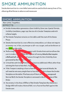

  15. ijw
    Infinity Rules Staff Warcor
    7,353
    14,845
    Does Smoke Ammunition help?
    Vanderbane, Stiopa and the huanglong like this.
  16. QueensGambit
    Jan 31, 2019
    2,213
    3,457
    Thank you @ijw . So, for 100% clarity, is that a confirmation that option 1 in the OP is correct in N4?

    I hadn't gone back and checked the rule: I was disagreeing with the method of argument (it was ruled like this in N3 so we can assume it works the same way in N4) rather than the content. Reviewing the content, I agree with you: it doesn't really need clarification, the N4 text stands on it's own.
