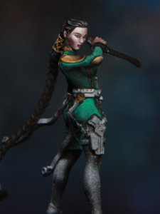

    wn7 size1 is my favourite for infinity. i paint very detailed faces with it including colored eyes (well avicenna is not the best example as she has dark brown eyes but you get the picture that the brush is not limiting me).
