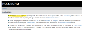

    That's my instinct too. @solkan also proposes it above. We'll see if anyone has any better ideas of how to reconcile the two wordings, but this is where I suspect we'll land.
    The question will then be, if you activate the state at deployment, are the two Holoechoes hidden, or just the real trooper?

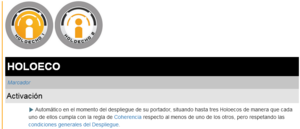

  4. I love it when someone takes part of a sentence from the rulebook and deliberately ignores the rest because it doesn't matter to their argument.
    And what do we do with the «placing up to three Holoechoes on the game table» part when the deployment is done without putting anything on the table? ... do we ignore it happily?... or is it that we only use the part of the rulebook that interests us?

  7. The rule you quoted says that it is activated by placing three Holoechoes on the table (it doesn't say being able to place, no, it says categorically placing), it also says «respecting the general conditions of the Deployment rules.» and Hidden Deployment is not a general deployment rule, it is precisely an exception to those rules; if you don't place the Holoechoes on the table when deployed you are not activating the State, as easy as that.

    The problem is the contradiction with Holoprojector, which is about being placed on the table: "This piece of Equipment allows its bearers to deploy in Holoecho State when they are placed on the table."
    The question is which is correct, what it says in Holoprojector or what it says in Holoecho State? They contradict each other as to when the skill is activated.
