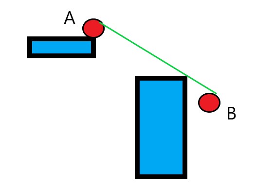

    In your picture? You say that the front rectangle is obscuring, and the rear rectangle is BtB, therefore there is no cover.
    Unless I'm completely misreading what you were trying to say, it sounds like you're suggesting that the front rectangle would have to be removed in order for the rear rectangle to be able to check both boxes.

    @toadchild
    Guess it’s my usage of language then. When I write ‘obscured’ I’m using it as an umbrella term for when CB use the words ‘covers’ and ‘conceal’ the model partially. If that makes sense.

  19. Zewrath
    Zewrath Elitist Jerk
    2,000
    3,484
    Aaahhh.. now I see what you mean.
    No, it’s just you and @ijw that don’t understand the question by the OP, perhaps due to his drawing not being more precise.
    This is what he means:
    Model A is clearly obscured and B can barely see him, but it doesn't matter shit because A is not in base contact with that massive building that obscures him, because it's not the current building he's in base contact with that covers his base.
    WarHound, Dragonstriker and toadchild like this.
  20. Sabin76
    Sabin76 Well-Known Member
    1,708
    2,086
    I'm pretty sure in his second post he said the the scenery he's in btb with would cover 1/3+...
