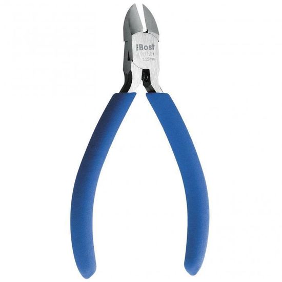

    I've beheaded a lot of mini I'm using this specific tool (dunno the proper word in english so it will be tool :p):
    never find better than this one, you lose the head (or the body depending on which side your puting the tool) with this but the cut is clean because you have a lot control during the "operation"
    you really need a good quality one and it should be completely flat

    Those would be clippers/cutters, sheer flush ones being the preference for most for clipping off and getting neatish cuts.
    Anyone buying any, avoid ones marked as plastic cutters as they're often a bit thicker at the blade, same for the Citadel ones. Also avoid cheap Chinese ones off ebay. I got 5 for £5 long ago, and as I suspected they were in fact barely strong enough to cut air without the blades snapping.

    More details: flush / side / micro-shear cutters / clippers (they leave one side of the cut flat =|<= instead of =><=) with tiny "jaws" so you can see what you are doing, used for electronics, capable of cutting soft metals (and plastics, but not hard metals) found in cables, chip legs, and other circuit components. Xuron are the expensive ones (20-30) like W&N series 7 brushes, Hakko or CHP or Wiha are other brands, Taiwan ones are OK for half price (10-15, Velleman VT301), Chinese are random. Visit an electronics shop, they will have other interesting tools, like files, helping hands, tweezers or clamps. And so do jeweler supply shops.

    That flat clipper looks good. Thanks for suggestion!
