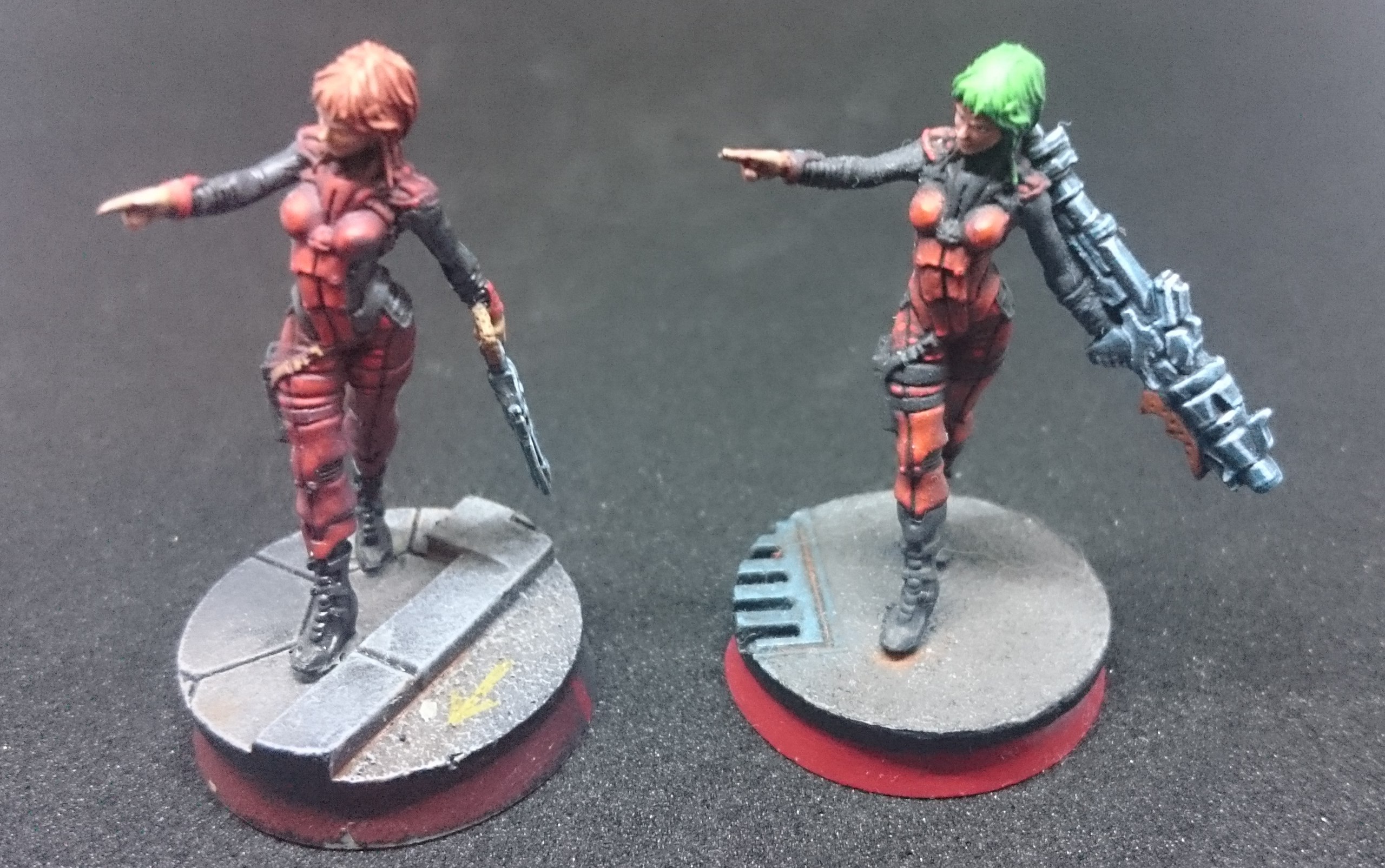

    Some weapon swaps:
    [​IMG] [​IMG] [​IMG]
    #71 Lucian, Feb 3, 2018

  18. Lucian
    Lucian Catgirl Nation
    989
    1,509
    Yeah, CCW Arm is from Combi Rifle Daturazi + Pistol is a heavy pistol from Raicho pilot + extra shoulderpad from some other Daturazi Arm. CCW Arm is a bit smaller (biceps), but posing and painting make it look okay
    I really wish I had bought a limited one while they were available...

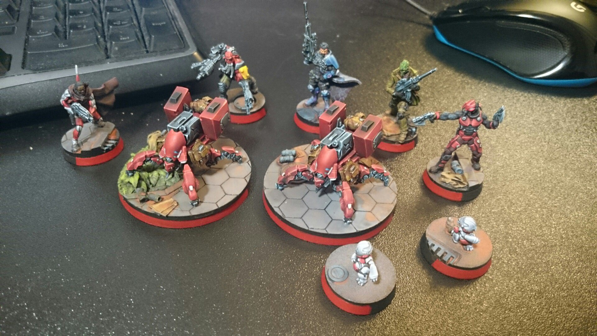

    Here is a group shot of some of my Ariadna conversions. Like I said, hate clones so saw and drill are my best friends. Converted all the grunts I need, now on to converting 3-4 chain rifle volunteers. Sadly they will all have to be male, since female volunteers are terribly scaled. This converted volunteer chain rifle looks a bit odd from this angle, but it's not. It is pointed at what he is looking at.
