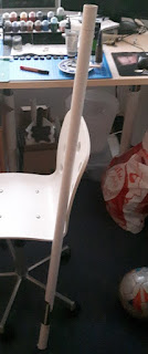

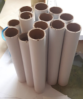

    For the trees, i needed some more time to decide on material, but found some tube packaging in the "useful for terrain later"-pile. One thing lead to the next:
    [​IMG] [​IMG] [​IMG]
    I even had time to test material for structure and colors:
    [​IMG] (yes, looks not like a tree, but is only a test prototype :smile:)
    So far, so good. :slightly_smiling_face:
    I will make slow progress, its my hobby project for 2018. If questions arise, ask.

    You went a different way than the usual method for these giant trees:
    But this should work juuuust fine.

    Have to go with the skills and materials i have. But i think, i will steal the idea with the branches. :smile:
