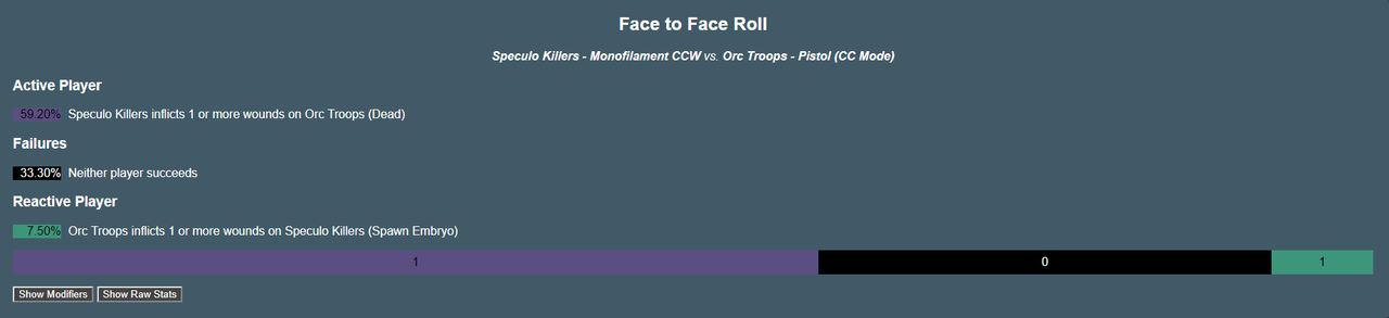

    Run the numbers on a linked ORC vs a speculo or fiday mate.
    Then add intelligent defence like sacrifical troops to prevent them getting into b2b and other plays.
    Think it through

    Woooooooow! It turns out (to none's surprise) that impersonator will shred your Orc as easy as your Fusilier.
    Dumb? You mean dumb plays? Because you do realise what happens when you cluster several troops on top of each other against impersonators with Shotguns and even Mines? They slice the pie, hit multiple of your models, throw smoke and proceed to slaughter your Datatracker in safety. Not sure why you take this so personal but no... an Orc isn't more durable against impersonators on any meaningful level. Im okay with you taking the Orc regardless of this information, just don't pretend otherwise.
    ...no? I'm sorry, what do mean exactly? Are you under the absurd impression that you get to fire back on 20's with 2 dices? Surely not, because that has nothing to do with the Orc being a better option, as it is about the Impersonator player being terrible.

    HAHAHA sure Zewarth, Dumb plays, just the sort of plays that win tournaments.
    And yeah, sticking a camo marker in front of your Data tracker to force a speculo to reveal to try and remove the obstacle preventing it from getting into B2B with teh data tracker, meanwhile the DT is shooting back at BS+3 and B2 is dumb....
    Sure mate, sure ;)
    EDIT: As to the numbers youve quoted, Sure, Worst case scenario, when Djabel has killed your link team (at least two other members) and then gotten smoke over the ORC and no effort has been made to force the impersonator to reveal early or face any form over overlapping defence they have some bad numbers.
    Who'd have thunk it, Bad playing leads to poor odds of winning.
    Now run the numbers on the ORC shooting back, forcing Djabel into a gunfight by preventing or limiting his abillity to get into B2B with the ORC.
    A Decoy marker or Mine in front of a corner deployed ORC that is then covered by a Jammer.....Im sure Djabel will love that......

    One big component of playing VIRD is that you should have both Jammers and Helots to deny area to any Impersonator. With both of those tools, there's no reason an Impersonator should have a safe place to throw smoke from. You can even make Speculative smoke tosses extremely difficult. It's a big reason I've been running double Jammers in missions where I need my Datatracker to live. With Jammer, you can make smoke tosses and CC runs close to impossible. You can force an opponent to try for the shotgun blasts, which linked PanO troops often defeat.
    It happened to me at Rumble, actually. Acquisition vs Haqq, I had an ORC HMG Datatracker. The 2 Wounds + Unconscious state was a big deal. Having 2 Wounds vs an Impersonator meant the difference between a strong finish and getting knocked into the middle of the pack. Jammer coverage meant the Impersonator couldn't capitalize.
    Also, I don't agree that you should avoid a durable Datatracker because someone might bring monofilament. That's like not bringing the Kamau MSV2 because someone might have White Noise. A handful of specific counters doesn't make a unit bad.
