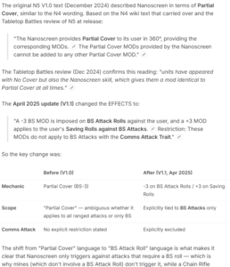

    Brave AI has an interesting take:
    and ends "while a Chain rifle (which is a Direct Template BS Weapon) does".
    It is visible how the wording changed from a "Partial Cover" to explicitly tying it to BS Attack. Nanoscreen intended as partial cover for someone that can't have it to explicitly limiting it to BS weapons

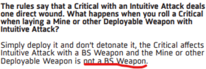

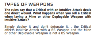

    I did some digging and found out that in N4 mines were openly classified as "not a BS Weapon".
    In FAQ 1.2 it reads:
    and in FAQ 1.7 is repeated:
    This was no longer necessary in N5 since Intuitive attack is done on WIP. The classification is shifted on the object that does the Intuitive Attack: if it is a BS Weapon then it activates nanoscreen, if it is a mine or a Crazykoala (it even gets in CC by movement) it does not
    In FAQ 1.2:
    https://assets.infinitythegame.net/downloads/faqs/en/v1.2/faqs.pdf (see page 6 right after title "Types of weapons")
    https://assets.infinitythegame.net/downloads/faqs/en/v1.7/faqs.pdf (see page 7 right after title "Types of weapons")
    This was no longer necessary in N5 since Intuitive attack is done on WIP. The classification is shifted on the object that does the Intuitive Attack: if it is a BS Weapon then it activates nanoscreen, if it is a mine or a Crazykoala (it even gets in CC by movement) it does not.

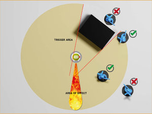

    I have another addition to the matter at hand.
    In N4 (Oct-2020) the picture of mines effect radius was this:
    now CB decided to update the picture in N5 showing this:
    The projections of the "shadow" on the total cover piece are not the same for the 2 versions. This is an indication that the small-teardrop template is just a ruler, a borrowed mechanic, for something that in reality does not work like a direct template BS weapon.

    As far as I know it works exactly like any direct template weapon now, meaning you put the template touching your "silhouette" and notcentered on the mine as in N4

    97
    What I pointed out is the shadow projection which clearly is not done by keeping the template radial with respect to the mine (otherwise you'll obtain the red lines in the N4 picture). What you say doesn't fit the picture since if I could put the "hole" wherever I so choose to obtain better angle, I'd end up with a smaller trigger area.
    In other words: in N5 the radius of the trigger area is done by moving the template around the edge of the mine token, keeping it radial. When you need to determine LoS on the other hand, you use the template to determine tangents like in the N5 picture (taken from the wiki, try prolonging the edges around the total cover and see where they end up). In this way you obtain a projection of the mine trigger are that takes into consideration the fact that the mine "can see" from any point along the edge, but the distance is along a circumference of radius (small-teardrop length) + (mine token radius).
    Still bearing in mind that the main forum topic is Monofilament mines vs. Nanoshield which was confirmed by rules that a mine does not trigger Nanoshield because a mine is not a BS Weapon (confirmed by N4 FAQ) is a part of it. The second part is that the Direct Template is just a ruler to design the trigger area and is sometimes consuming in the mines mechanism.

    I'd say the figure is just... well, crap:
    One of the lines is not even a tangent of the mine token's circumference. An thus can't even be considered part of the Mine's legal trigger area
    #56 Tristan228, Oct 25, 2026 at 3:48 PM

    97
    It's on the Wiki, I don't write the wiki. Being as you are a Warcor and have a channel to CB I am sure you'll find the time to report a problem to the game's creators. The substance of the argument don't change much: that model would still be hit and the teardrop is still a ruler
