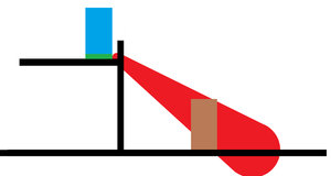

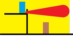

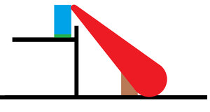

  20. In a more serious way than my previous message.
    @bardulf I think the example you put is the following:
    1.- First the «Trigger Area» (yellow zone) is verified from the SX silhouette or base of the mine (green rectangle), which makes the miniature (brown rectangle) be in that area.
    2.- Once you see that it is in the «Trigger Area» then you place the template on the S2 of the camouflage marker (blue rectangle) to see that the model is not in total cover and can be affected by the detonation.
    What you are not taking into consideration is that when defining the "Triger Area", the Total Coverage areas must be taken into account (in the «Verification», we could say) and you assume that since it is not in Total Coverage in the «Resolution» that It implies that it is not in the «Verification» either, but there is no possible physical way that in the «Verification» you can put the template in any way that can partially cover the silhouette of the miniature, that does not imply going through the wall.
    #40 Pettynyt Pelaaja, Jul 17, 2021
