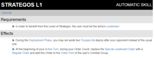

    When do you announce that you're using Strategos to reserve an extra model? Is it after you deploy all but your two reserved models or is it when you're deploying the two reserved models? Does it depend on when the model with Strategos is deployed?
    Similarly, when do you announce the Strategic Use of Command Tokens to reserve an extra model?

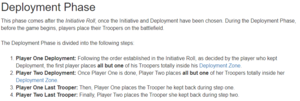

    You announce and spend command token during your deployment, aka during the first step where you're placing models.
    You spend the command token, announce that you're holding back two models, and then your opponent proceeds with their deployment.

    Devils advocate: Both the Strategic Use of Command Tokens and Srategos reference Deployment, but not a specific time in deployment (e.g. before you reserve models). Couldn't you flip the command token when you deploy the extra reserved model or similarly, announce Srategos when you deploy the extra reserve model? Both would still be in the Deployment Phase.

    For Command Token usage, it specifies "... during his Deployment," which seems to be step 1 of the Deployment Phase (Player One's Deployment).
    Strategos is much less clear, unfortunately, so it'd be nice if CB could step in and clarify.

    I would say no, because the command token usage rule says that you use it to "set aside" an extra trooper. If you don't spend it during your initial deployment, you have to deploy everyone except your one allowed set-aside (and drop troops which have a specific exemption in their rule).
    Likewise, Strategos lets you "set aside" an extra trooper so I think it's clear that it happens during your initial deployment.
    I think it's less clear whether you have to announce the use of Strategos at all. @Mahtamori makes a good point about @ijw's rulings - but I think there was also a thread about the use of NCO by a camo token, where @ijw suggested that deployment skills aren't the same as order-using skills. And the subsequent FAQ arguably cements the idea that you have to announce the use of a skill specifically when using it as part of your order expenditure. Unfortunately I tried to search for the NCO thread and couldn't find it :-(
    But if you have to announce the use of strategos, then I think it would have to be announced in the initial deployment phase when the extra trooper is set aside.
