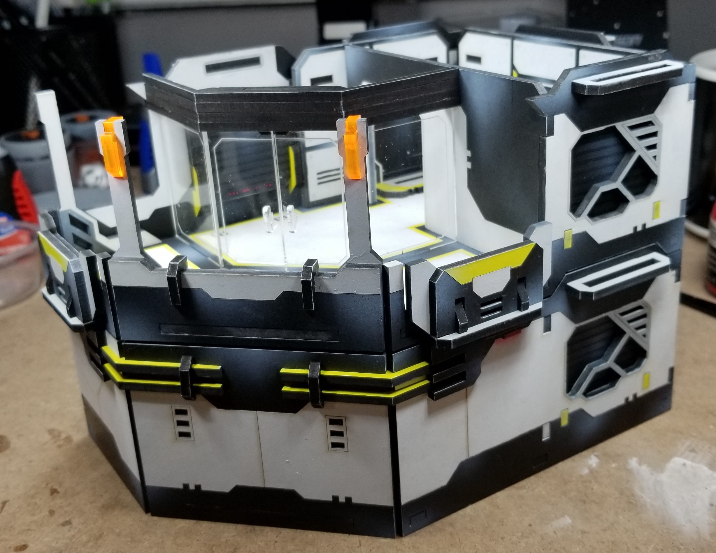

    Hey People,
    I've started a secondary project aside from the OSS army I'm painting. Going with a Mass Effect Cerberus theme. The terrain comes from LosBlock . Particularly their CITY 3000 - Armotek Corporate Unit
    <<< WARNING!!! PIC HEAVY!!! >>>
    Here's some concept art that inspired me:
    I'm going with a monochrome theme with yellow as a contrast.

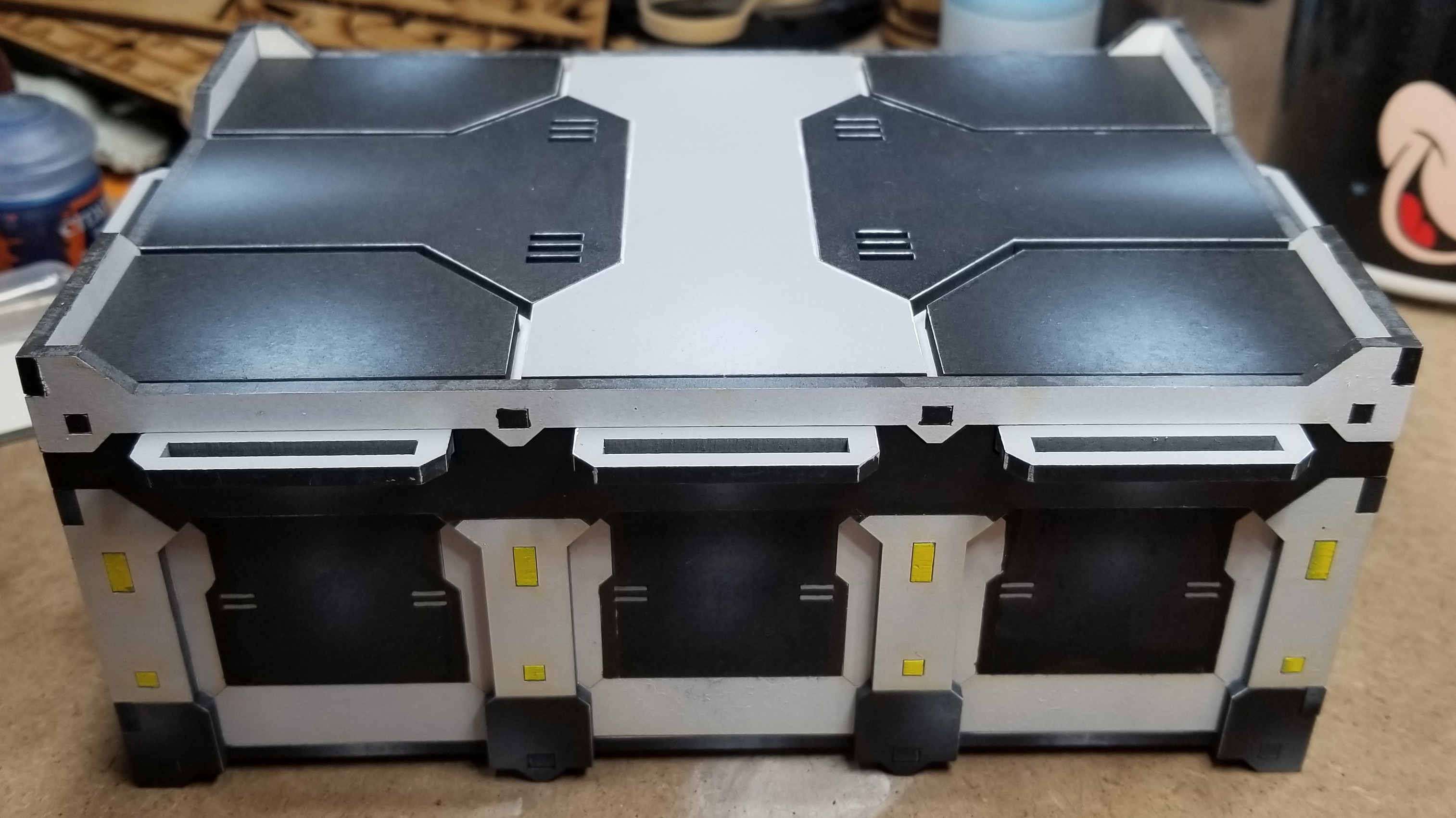

    Here's the first building I finished:
    Off to a strong start! More pieces to come.

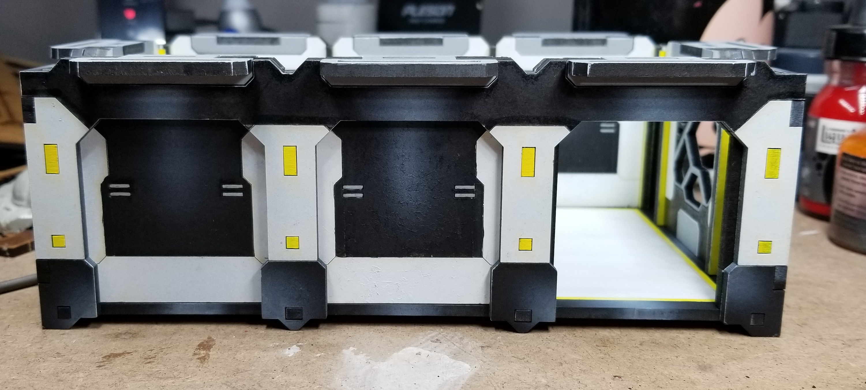

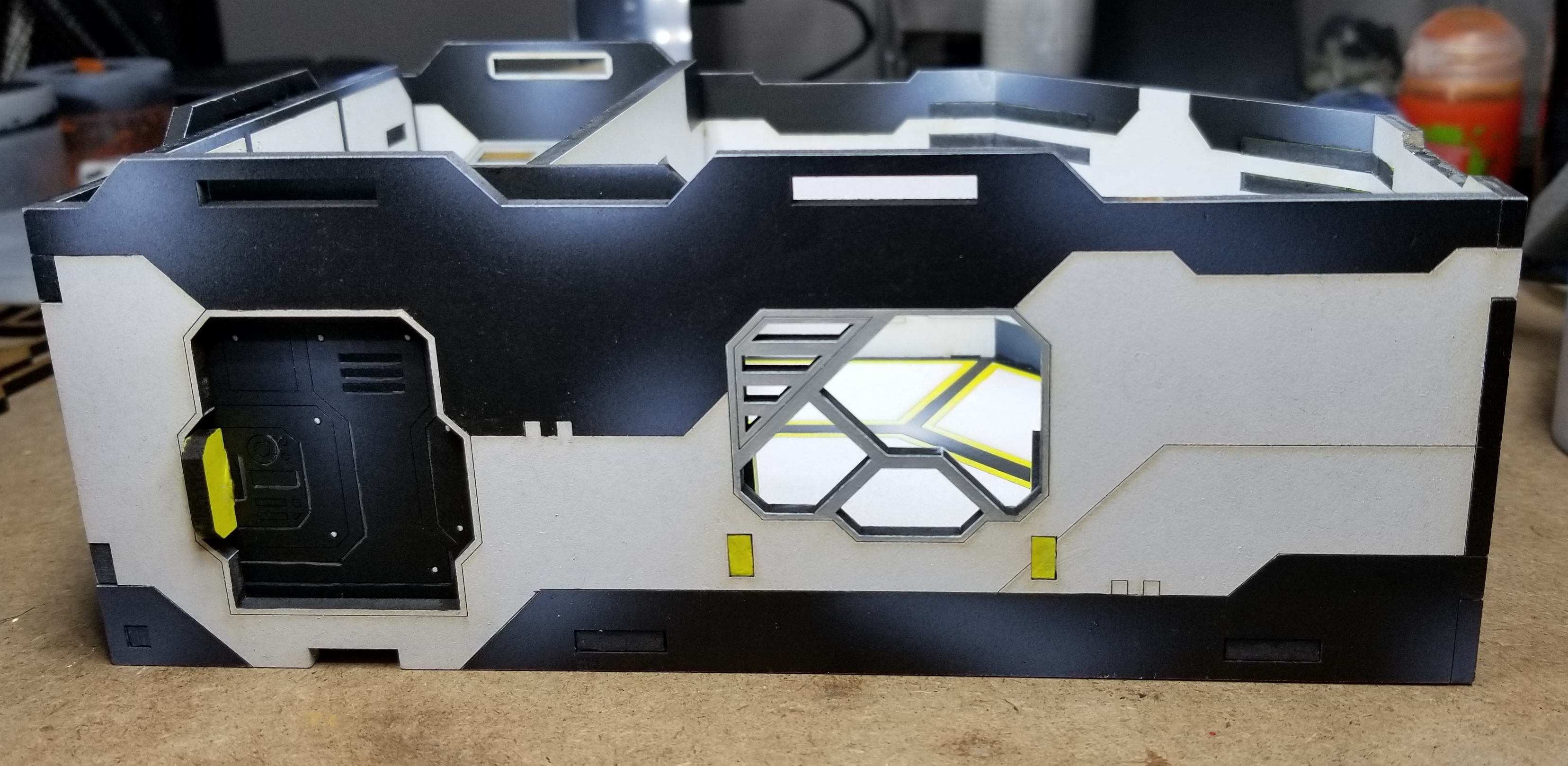

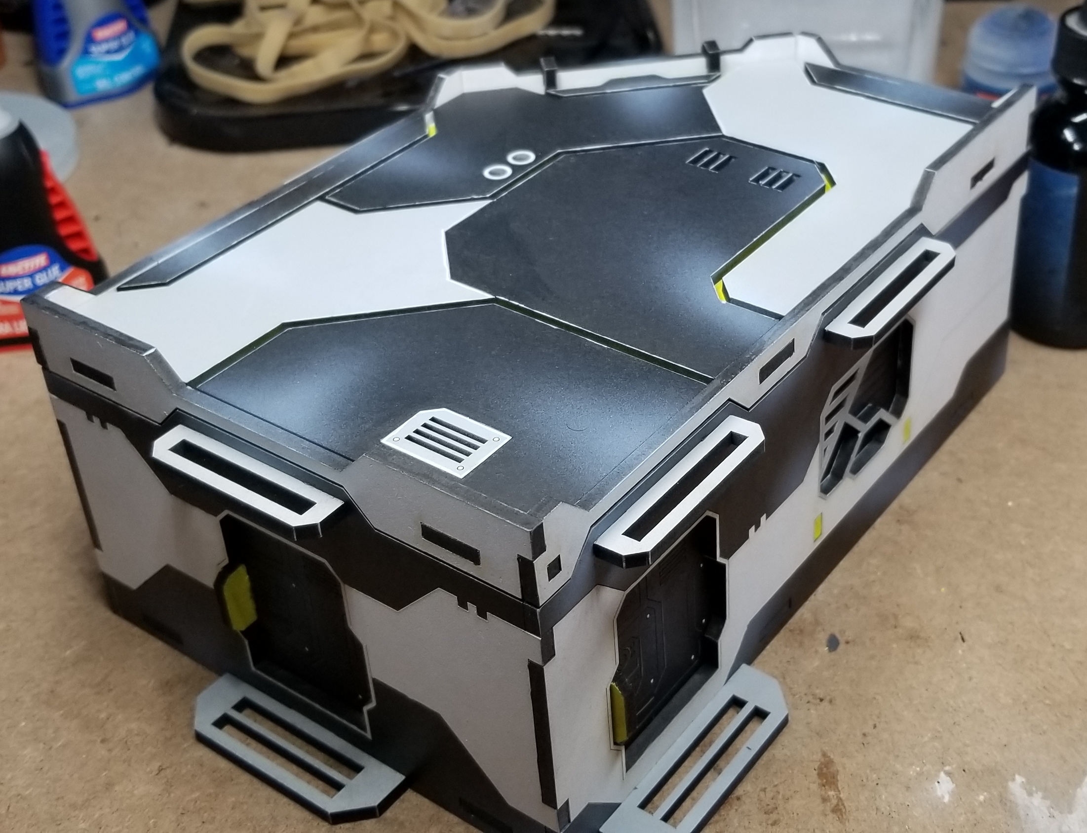

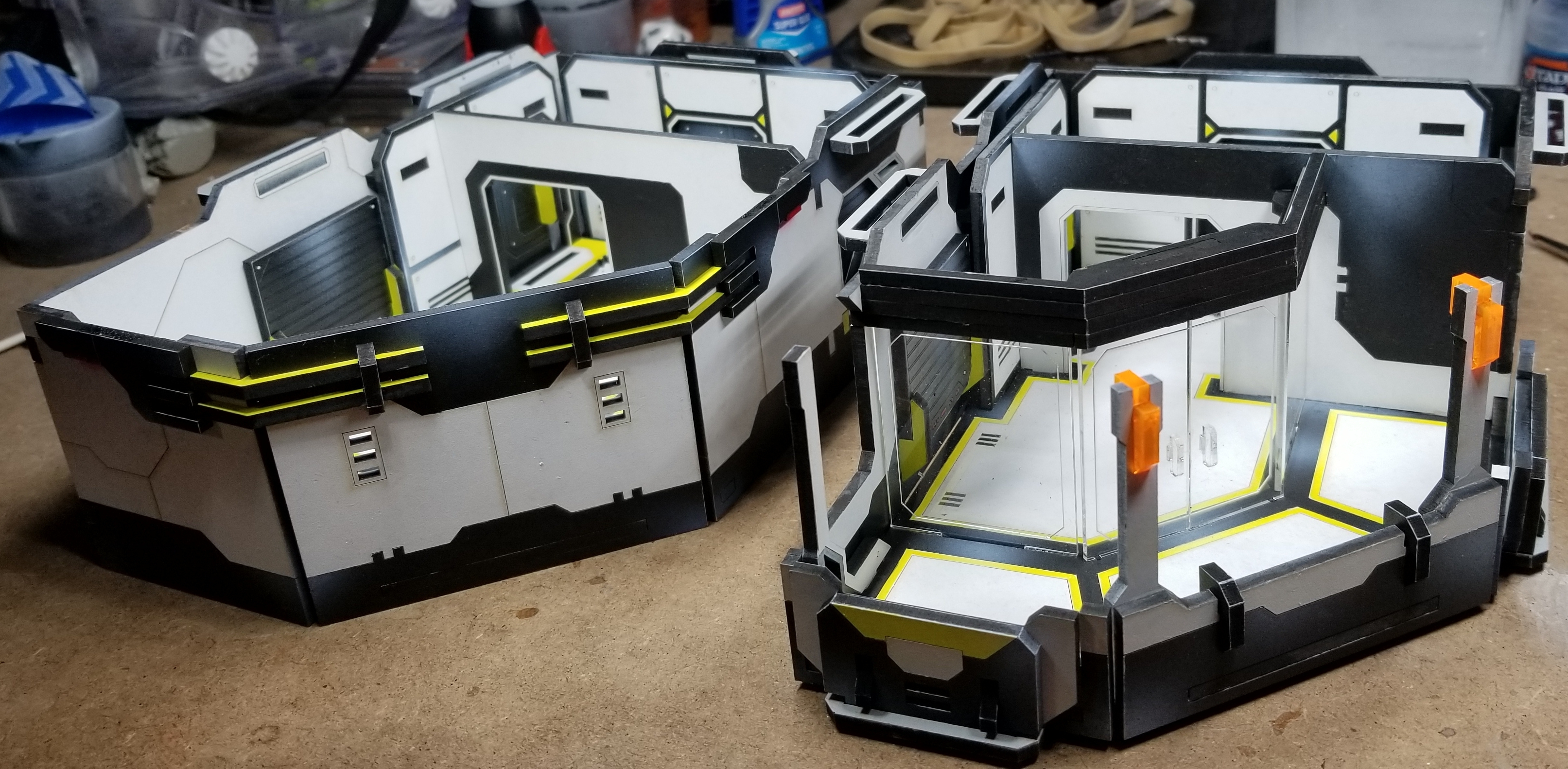

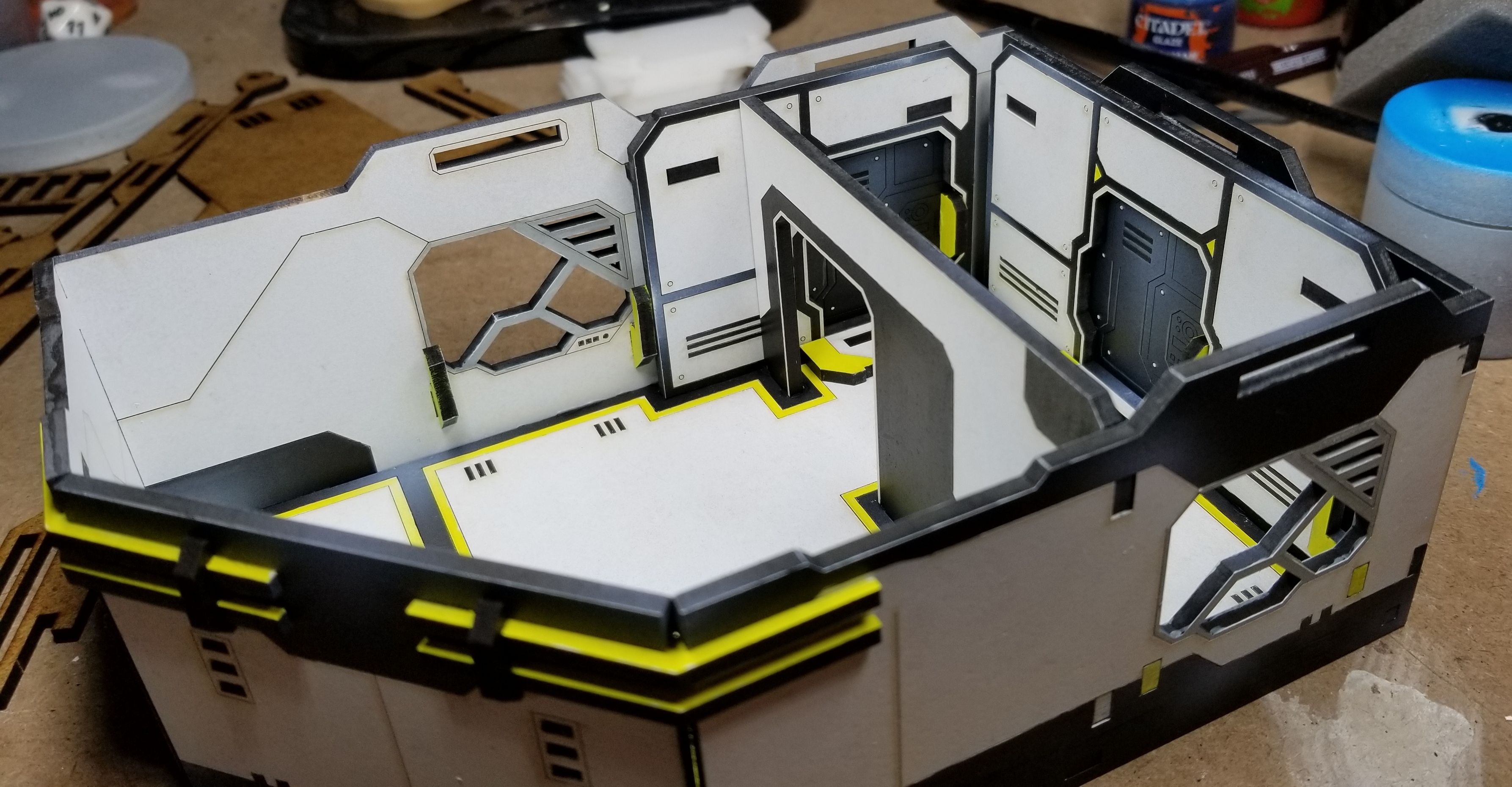

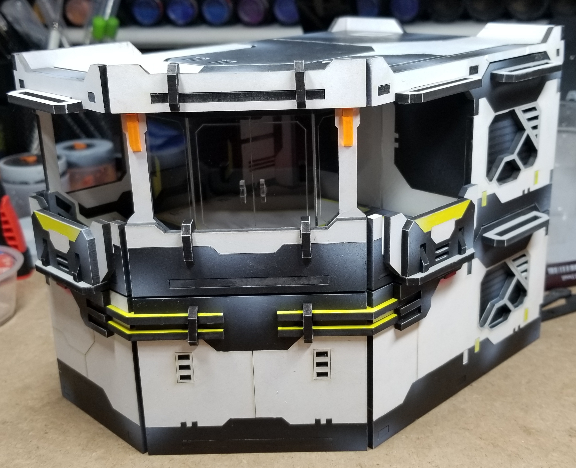

    Here's the 2nd & 3rd buildings.
    Closed Living Cell
    Additional Floor
    Combined
    More pics to come.

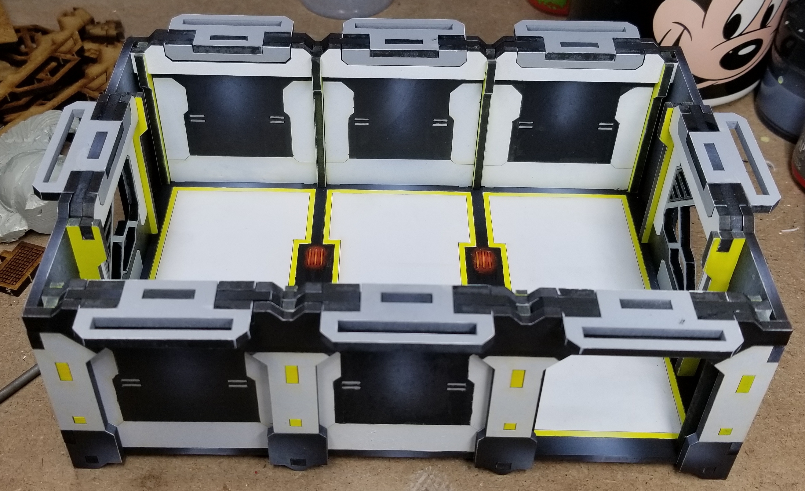

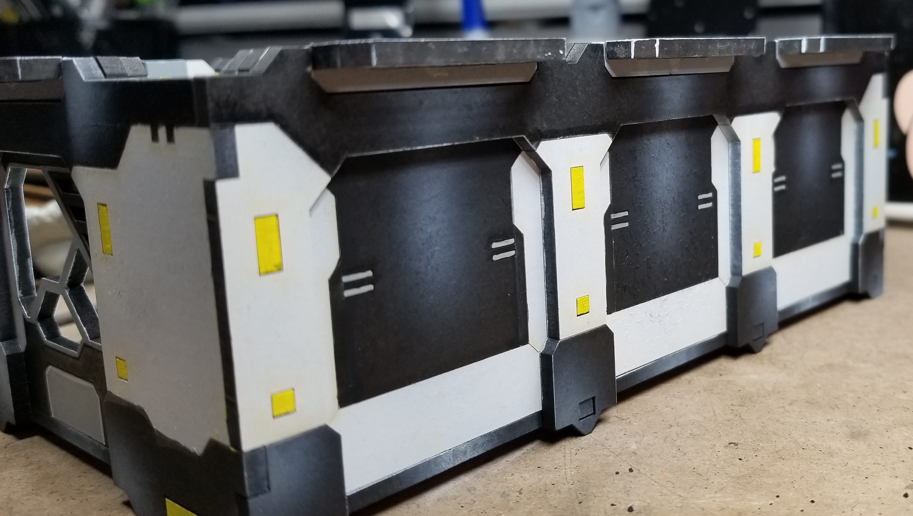

    Damn! I thought I was going crazy how much acrylic ink I was running through. This material is so friggin' thirsty!
    When I used to rattle-can prime I used Krylon Camouflage 4290 Black. I haven't had a need to replenish for a few years. I'll go on a hunt today for some.
    In the mean time, more pics!

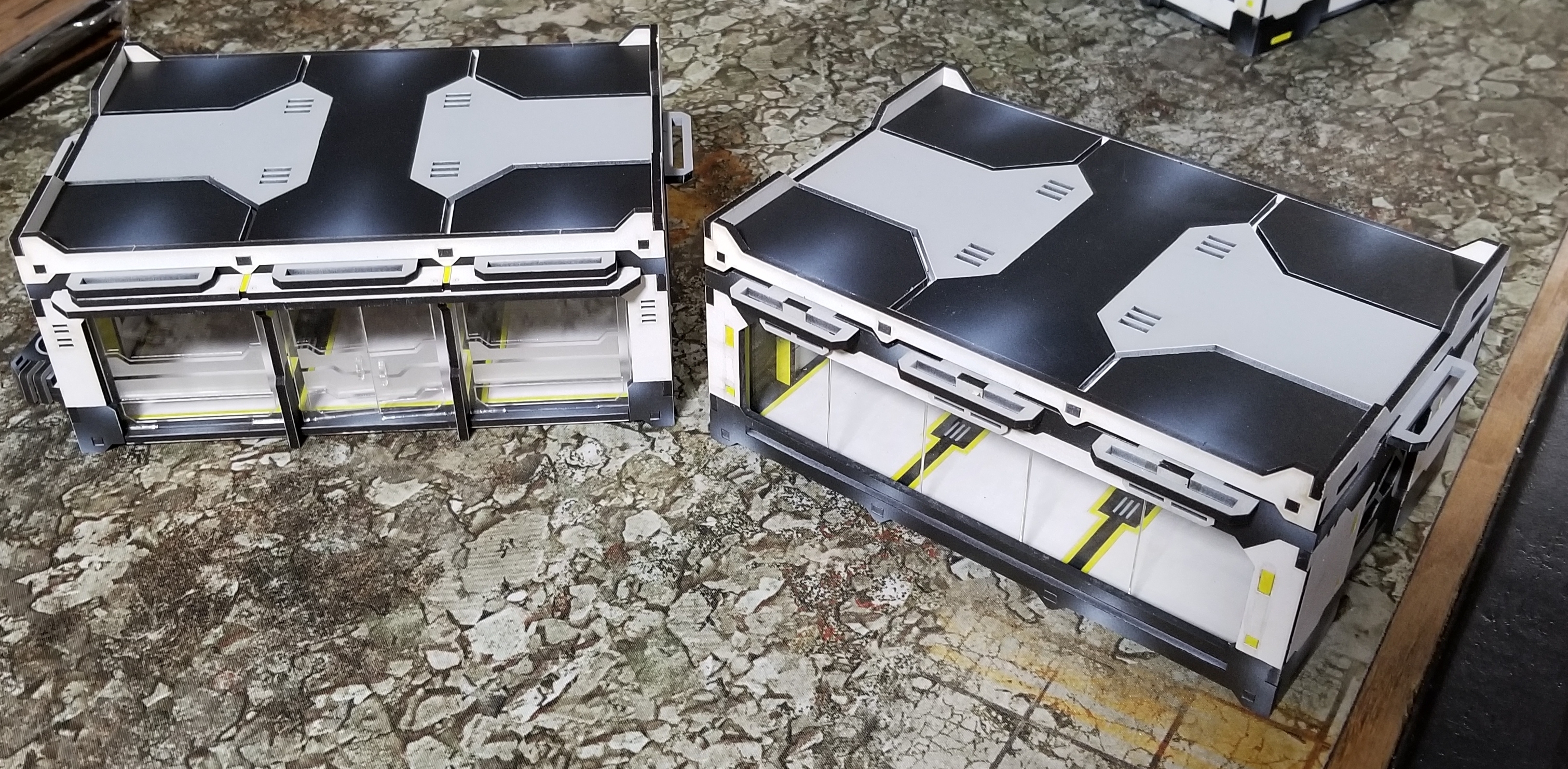

    Universal Modules - Glass fronts
    Here's a few group shots of the finished buildings:
    I've started work on the ground tiles so I don't get bored painting buildings. I'll have pics of those ready soon.
