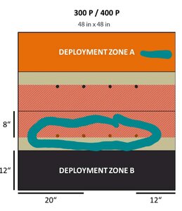

    "Each player will place their four Civilians inside the Exclusion Zone, but in Silhouette contact with the limit of the enemy Dead Zone, in the adversary’s half of the table. Two of them must be placed 12 and 20 inches respectively from one of the edges of the table, while the other two must be placed 12 and 20 inches respectively from the other edge for 400/300 Army points games (see the map below)."
    If I understand that correctly, my civilians are placed in the EZ, but on the enemy side of the EZ.
    Am I correct on that?
    Thanks
    Doug
  2. colbrook
    17,155
    Correct, if you were deploying in Deployment Zone A, your civilians would be the ones I've circled.

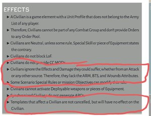

    I might have missed it, but does the game end if any of the civilians are taken out by 'accidental' fire?
  5. colbrook
    17,155
    From page 9 of the ITS 13 document, civilians are essentially invulnerable.
