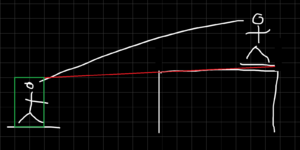

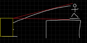

  8. iKon
    iKon Not Very Well-Known Member
    Feb 27, 2018
    293
    323
    There is cover because the building that the target is in contact with obscures part of its silhouette from the attacker.
    chromedog likes this.
  9. psychoticstorm
    6,783
    12,458
    That is correct, if the silhouette was slightly higher (or the building a bit lower) then there would be no cover.

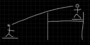

  10. iKon
    Feb 27, 2018
    293
    323
    paddyBatman and Brokenwolf like this.
  11. psychoticstorm
    6,783
    12,458
    Correct.
