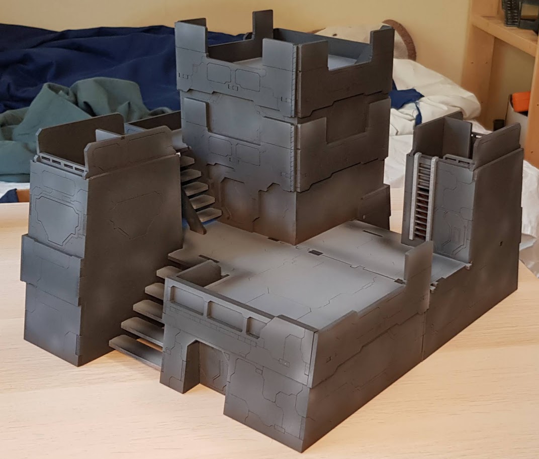

    The lines are deep enough to still be visible after painting. If the whole thing is black they won't stand out much but even with a dark grey you can easily see them.
    Here is MAS building set (Precinct Sigma Pack) painted with Vallejo German Panzer Grey and some shading with lighter greys and even with colors that dark the lines are still clearly visible:
