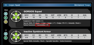

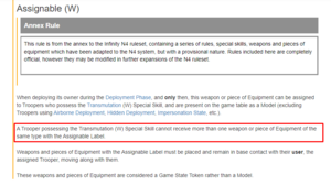

    What REALLY throws us in addition is the SymbioBomb game example:
    The Gorgos Squad has Transmutation(W) and the rules explicitly state
    A Trooper possessing the Transmutation (W) Special Skill cannot receive more than one weapon or piece of Equipment of the same type with the Assignable Label.
    1. How can the Kaeltar assign a SymbioBomb to the Gorgos IN ADDITION to the existing SymbioMate?
    2. How can the Gorgos even have a SymbioMate already? From a second Kaeltar?
    3. What does "Equipment of the same type" mean? What does type even mean, specifically? Aren't SymbioBombs and SymbioMates "Equipment of the same type"?
    4. Is this specific paragraph of the Labels just there to try and make it clear that a trooper can not have more than one of either SymbioMate or SymbioBomb?
    5. How can the Kaeltar even assign TWO SymbioBombs in the same deployment? (that would hint at option No.1 from above being true)
    6. Is it implied here that the Kaeltar can assign as many SymbioMates and SymbioBombs as he likes but only ONE per troop? (he basically has to choose either Mate or Bomb for each individual troop, not both)

  2. tox
    tox SorriBarai
    3,711
    3,707
    I think that the right answer is 4. A single model cannot have more than 1 Mate or more than 1 Bomb. One each shuold be ok.

    4 is not right because any unit with Transmutation (W) can have one of each... in option four he mentions "a trooper can not have more than one of either SymbioMate or SymbioBomb".
    The thing here is that, as he asks before in option 3, Mates and Bombs are different types of equipment. So having one of each is not a problem.

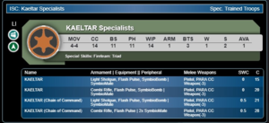

    Friend just reminded me that there are profiles with f.e. "2 x Symbiomate" upload_2021-10-28_17-5-52.png
    That would imply option No.2 being true with the adage that the profile states the amount of Bombs or Mates the unit can assign at deployment.

    The Kaeltar with the 2x Symbiomate means that he carries two Symbiomates that he has to assign during deployment. As troopers cannot have more than one assigned, it just means that the Kaeltar gives one Symbiomate to one trooper, and another Symbiomate to another trooper.
    Sadly, ruleswise Inifnity is not as tightly written as Magic.
    Lawson and Indrome like this.
