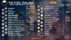

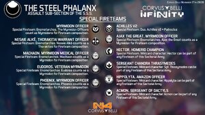

    I just want to confirm something, under N4´s Enomotarchos, we can mix Dactyls, Thorakitai and Myrmidons on the same fireteam? There is no mention to different enomotarchos units anymore, the characters also do not form teams with X or Y, they just "count as".

    It is also not clarified in the charts... It seems too good to be true, but without a FAQ I believe it would be legal.

    It is not a special Fireteam, it is a normal type of Fireteam like Core, Haris, or Duo.
    Special Fireteams are listed in the Sectorials chart very clearly such as "Special Fireteam: Duo, Achilles v2 + Patroclus FTO."
