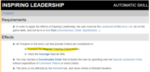

  1. @HellLois and @ijw I have the following question: what happens when a troop is isolated if the lieutenant has Inspiring Leadership?
    Isolated makes the troop irregular and prevents from using reserve orders (among other things) but, the lieutenant's special skill would make it regular again? ...
    Which rule would have priority?

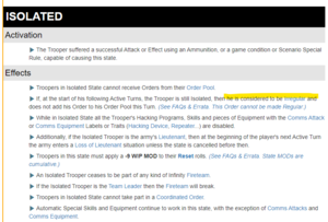

    "If, at the start of his following Active Turns, the Trooper is still Isolated, then he is considered to be Irregular and does not add his Order to his Order Pool this Turn. (See FAQs & Errata. This Order cannot be made Regular.)"
  3. Inspirational Leadership does not transform the Irregular Order into a Regular Order, it gives the troop the Regular Training Characteristic.
    So, one rule is giving to the troop the Irregular Training and another the Regular ... which one has priority?
    Or, in what order do these rules apply? , because it is not the same first to make it Regular and then to become Irregular than the opposite.

    You can possess the Regular Training even if yuo are Irregular, but when you get Isolated...
    You are considered Irregular nonetheless.

  7. QueensGambit
    Jan 31, 2019
    2,213
    3,457
    I would probably rely on the "and" in the Isolated rule, and say Isolated has three distinct effects:
    1. Cannot receive orders from the Order Pool
    2. Is considered to be Irregular
    3. Does not add his order to the Order Pool
    Even if the presence of an Inspiring Leader cancelled (2), it wouldn't cancel (1) and (3) so the Isolated trooper would be Regular but would nonetheless not add his order to the Order Pool (or receive orders from the Order Pool).

  12. Mahtamori
    12,076
    15,386
    The rules that you are looking for are the rules for the order pool itself, the trooper and the order are not required to be sent anywhere, but rather the pool itself will take them from all regular troopers. It is correct that the way the rules are written doesn't explicitly (as is the case for e.g. Hidden Deployment) allow the interpretation that the trooper retains the order outside the order pool, but this is also not something the rules prevent.
    I do note, however, that there's an unsolved race condition between Isolated (trooper is considered to be irregular) and Inspiring Leadership (trooper is considered to be regular) because they use the same wording and neither change the trooper's actual training. I think that simply put, Isolated's "does not contribute to pool" provides a trump that Inspiring Leadership does not mirror. I think mechanically QueensGambit's parsing is correct and neat since it confirms the casual understanding.
