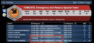

  10. Robock
    Robock Well-Known Member
    1,246
    858
    oops i thumb up inane post too fast, i thought you were talking of zondbot (which are purchase separately and in my list printed a long time ago i forgot if i build the list with the zondbot attached to the clockmaker or to the daktari). For zondcat, if he belong to the tomcat eng or the tomcat doc is apparent in the cost and value it gives to kill them.
    Compare
    [​IMG] Jurisdictional Command of Corregidor
    [​IMG]2
    [​IMG] TOMCAT Engineer Combi Rifle + Light Flamethrower, D-Charges + 1 Zondcat / Pistol, Knife. (0 | 26)
    [​IMG] [​IMG] ZONDCAT Electric Pulse. (4)
    [​IMG] TOMCAT Doctor (MediKit) Combi Rifle + Light Flamethrower / Pistol, Knife. (0 | 22)
    0 SWC | 48 Points
    Open in Infinity Army
    With
    [​IMG]2
    [​IMG] TOMCAT Engineer Combi Rifle + Light Flamethrower, D-Charges / Pistol, Knife. (0 | 22)
    [​IMG] TOMCAT Doctor (MediKit) Combi Rifle + Light Flamethrower + 1 Zondcat / Pistol, Knife. (0 | 26)
    0 SWC | 48 Points
