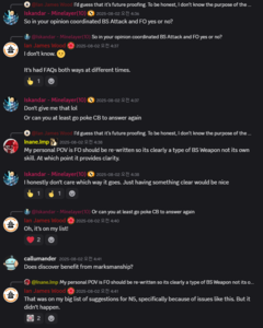

    In other words, can I use coordinate order with one shooting rifle and another declaring forward observer? Peripherals and fireteam ARO can have similar situation.
    Forward Observer skill says "The use of Forward Observer is a form of Attack with a BS Weapon with the BS Weapon (WIP) Trait", so it seems not a common BS attack skill. However, the requirement of BS attack common skill says "Be using a BS Weapon, or a Skill or piece of Equipment capable of making a BS Attack." and that skill seems to include forward observer skill. I think this is not clear and need some clarification.
