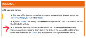

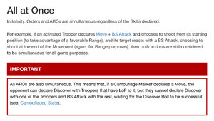

    No, this is not correct. Apart from anything else, by the time Trooper A is making their Discover Roll, it’s much too late for Trooper B to declare a BS Attack!
    The Camouflaged rules state that delaying Troopers only get their ARO if the Camouflaged Trooper reveals themselves:
    And also all AROs are simultaneous, see the red box example on the Trooper Activation page:
