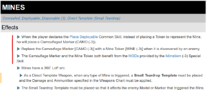

  5. Iskandar
    Iskandar Well-Known Member
    Sep 14, 2021
    170
    250

  6. surfimp
    surfimp Active Member
    Apr 27, 2020
    24
    30
    Yes, I see that now, obviously, though I should note that the hyperlinks there point to the "Labels" page, and not the individual traits.
    Also, with how explicit the rest of this effects block on Mines is, I feel it's a missed opportunity to reduce confusion by failing to include mention of the Silhouette 2 trait of the interaction of Concealed > Camo > Deployable > Weapons & Equipment here. It's like the one thing left out of an otherwise extremely verbose block.
    Further doubts are introduced when the weapon block indicates SX as the Silhouette, though as noted this only applies to the Mine once discovered.
    I see the N4 rulebook is where this all originates, I'm just saying it's an opportunity for improvement.
