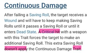

    I might add that there
    Just for the sake of completeness I might add that this rule also has it's exception, namely the Continuous Damage Trait:

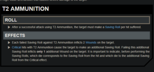

    T2 also works unlike you'd expect
