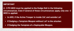

    I would also say that according to my understanding you are correct, I just don't see there being a redistribution of hits after resolution step.
    And as Errhile points out, a trooper cannot declare ARO to shooting while Engaged in CC, unless they have Sixth Sense or if shooter was inside ZoC, since Engaged trooper cannot draw LoS outside of CC.
    And if shooter is within ZoC, target then gets -3 to Dodge, due to being inside ZoC but outside LoF (unless if they have Sixth Sense).
