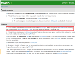

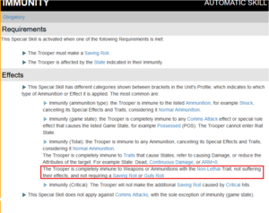

    just admiring the new version of the army generator and noticed this when checking the wiki linking worked
    looks like you need to go close and personal to revive models with total immunity as it cant be turned off.
    gizmokits read the same way for their ranged mode

    Automatic Special Skills and Automatic Equipment have no effect while Unconscious
    But it *does* mean that you can't use a Gizmokit to repair a Karakuri that isn't Unc.

    Nor Sun Tze, Volklak, Namurr, Valkyrie or Willy Wally when in No Wound Incapacitation state

    Nor Cameronian, big form Doge Warrior, Duroc, Devil Dog, etc, after they lost the first of 2 Wounds on big boy form then?

    You can't heal a non-NWI, non-UNC Trooper with Ws with a Medkit. So the only time you're allowed to use a Medkit on a Dog they're UNC and therefore their TI doesn't work anymore (which means that you can use the Medkit at range).
    It's peculiar to STR or NWI that you can use a Gizmokit/Medkit on a Trooper while they still have their Automatic Skills working.
